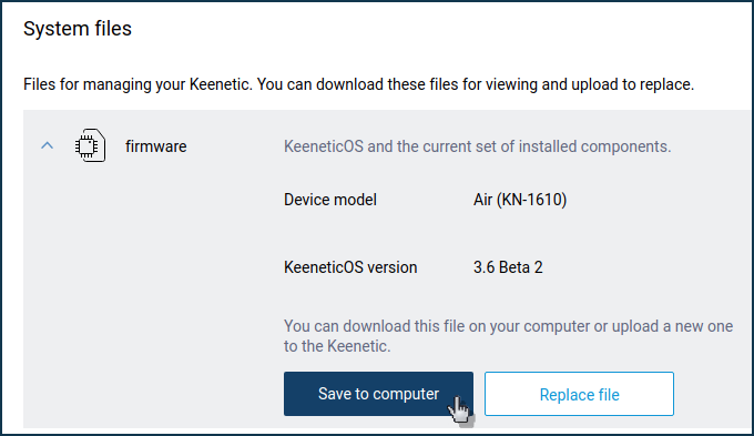

Question: Can I save the current KeeneticOS image and user settings (configuration file) before the OS update?
Answer: Yes, it is possible, and we recommend doing so. Save the current router firmware file and the user settings (startup-config) on your computer. With these system files, you can reset the router's settings at any time. Connect to the Keenetic web interface and go to the 'System settings' page. In the 'System files' section, select the firmware file and click the 'Save to computer' button to download this file's copy (the router's OS).
Your web browser will download the KeeneticOS operating system file (.bin file). If the 'Save file' window appears, specify the location (the folder where the file will be saved) and click 'Save' or 'OK'.
See 'Saving KeeneticOS image to a file' for more information.
As a result, you will save a backup file of the router's built-in operating system on your computer, containing the currently installed version of KeeneticOS, with your set of components.
Later, if necessary, you can restore the saved version of the system. You can do this by following the instructions Updating KeeneticOS by a system file.
As for the Keenetic configuration, you can save the current user settings by clicking on the startup-config file entry.
You will find more information in the instructions 'Saving the startup-config configuration file'.
