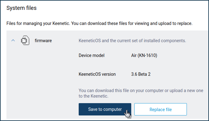

Answer: Yes, it is possible, and we recommend doing so. Save the current router firmware file and the user settings (startup-config) on your computer. With these system files, you can reset the router's settings at any time. Connect to the Keenetic web interface and go to the 'System settings' page. In the 'System files' section, select the firmware file and click the 'Save to computer' button to download this file's copy (the router's OS).
Your web browser will download the KeeneticOS operating system file (.bin file). If the 'Save file' window appears, specify the location (the folder where the file will be saved) and click 'Save' or 'OK'.
See 'Saving KeeneticOS image to a file' for more information.
As a result, you will save a backup file of the router's built-in operating system on your computer, containing the currently installed version of KeeneticOS, with your set of components.
Later, if necessary, you can restore the saved version of the system. You can do this by following the instructions Updating KeeneticOS by a system file.

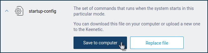

As for the Keenetic configuration, you can save the current user settings by clicking on the startup-config file entry.
You will find more information in the instructions 'Saving the startup-config configuration file'.

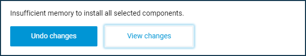

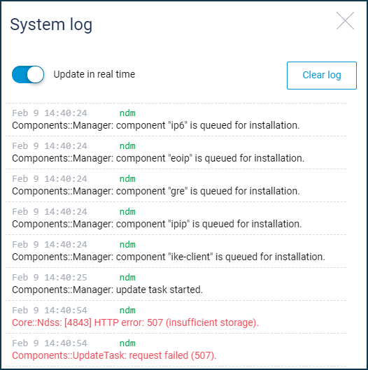

Question: Why can't I update KeeneticOS? A 'request failed 507' error occurs. The router's system log also contains a message with error number 507: 'request failed (507)' and 'error:507 (insufficient storage)'.
Answer: Error 507 during an operating system upgrade means that the router does not have enough internal memory to install the selected components. We recommend you uninstall unused components before the update. This is due to hardware limitations. This error may occur on entry models with 16 Mbytes of Flash memory.

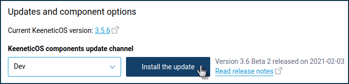

Answer: Dev (test, bugfix, debug) versions are released by the developers and are available for installation. Information about testing can be found on the Keenetic Community forum. These versions have the same functionality as Main and Preview releases and contain additional bug fixes and new features. The latest Dev version available usually contains a fresh set of components that are used in current releases. This version differs from 'stable' releases in that it is not fully internally tested and is therefore distributed on an 'as is' (or 'at your own risk') basis. The Dev version is initially intended to test fixes' workability and get familiar with new features. This version may contain bugs.
Important! Be careful when installing Dev builds! Before installing the KeeneticOS version from the Developer channel, we recommend you make a backup of the current router configuration by saving the startup-config.txt file and the Keenetic OS system file with the current set of installed KeeneticOS components. This will allow you to quickly restore the device configuration to its previous state if needed. Refer to the Updating KeeneticOS by a system file guide for more information.
You can update the router's OS to the latest available Dev version from the router's web interface or via the command-line interface (CLI).
If installing the Dev version of KeeneticOS via the web interface, open the 'General system settings' page, under 'Updates and component options', select the 'Dev' build update channel and click 'Install the update'.

Answer: Due to the different hardware configurations of Keenetic routers, it is not guaranteed that all components and specific combinations of components available for a particular model can be installed simultaneously. This is usually the case for junior models with up to 16 Mbyte of Flash memory. Also, some operating system components are mutually exclusive and cannot be run simultaneously. We recommend uninstalling the components you do not use and then installing the ones you do need. The recommended set of components can be obtained by installing the KeeneticOS operating system for your router from the Download Center section.
